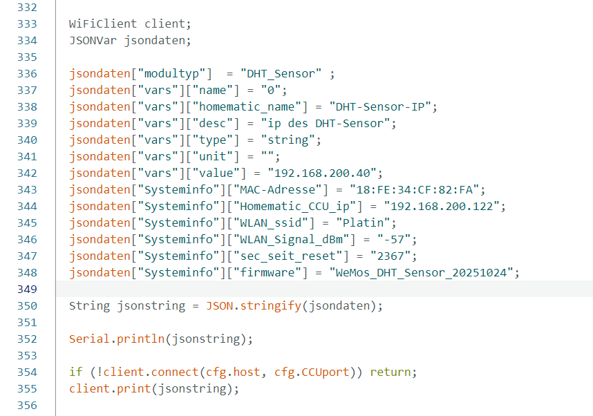

          <  WiFiClient client;
            JSONVar jsondaten;
            jsondaten["modultyp"]  = "DHT_Sensor" ;
            jsondaten["vars"]["name"] = "0";
            jsondaten["vars"]["homematic_name"] = "DHT-Sensor-IP";
            jsondaten["vars"]["desc"] = "ip des DHT-Sensor";
            jsondaten["vars"]["type"] = "string";
            jsondaten["vars"]["unit"] = "";
            jsondaten["vars"]["value"] = "192.168.200.40";
            jsondaten["Systeminfo"]["MAC-Adresse"] = "18:FE:34:CF:82:FA";
            jsondaten["Systeminfo"]["Homematic_CCU_ip"] = "192.168.200.122";
            jsondaten["Systeminfo"]["WLAN_ssid"] = "Platin";
            jsondaten["Systeminfo"]["WLAN_Signal_dBm"] = "-57";
            jsondaten["Systeminfo"]["sec_seit_reset"] = "2367";
            jsondaten["Systeminfo"]["firmware"] = "WeMos_DHT_Sensor_20251024";
            String jsonstring = JSON.stringify(jsondaten);
            Serial.println(jsonstring);
            if (!client.connect(cfg.host, cfg.CCUport)) return;
            client.print(jsonstring);

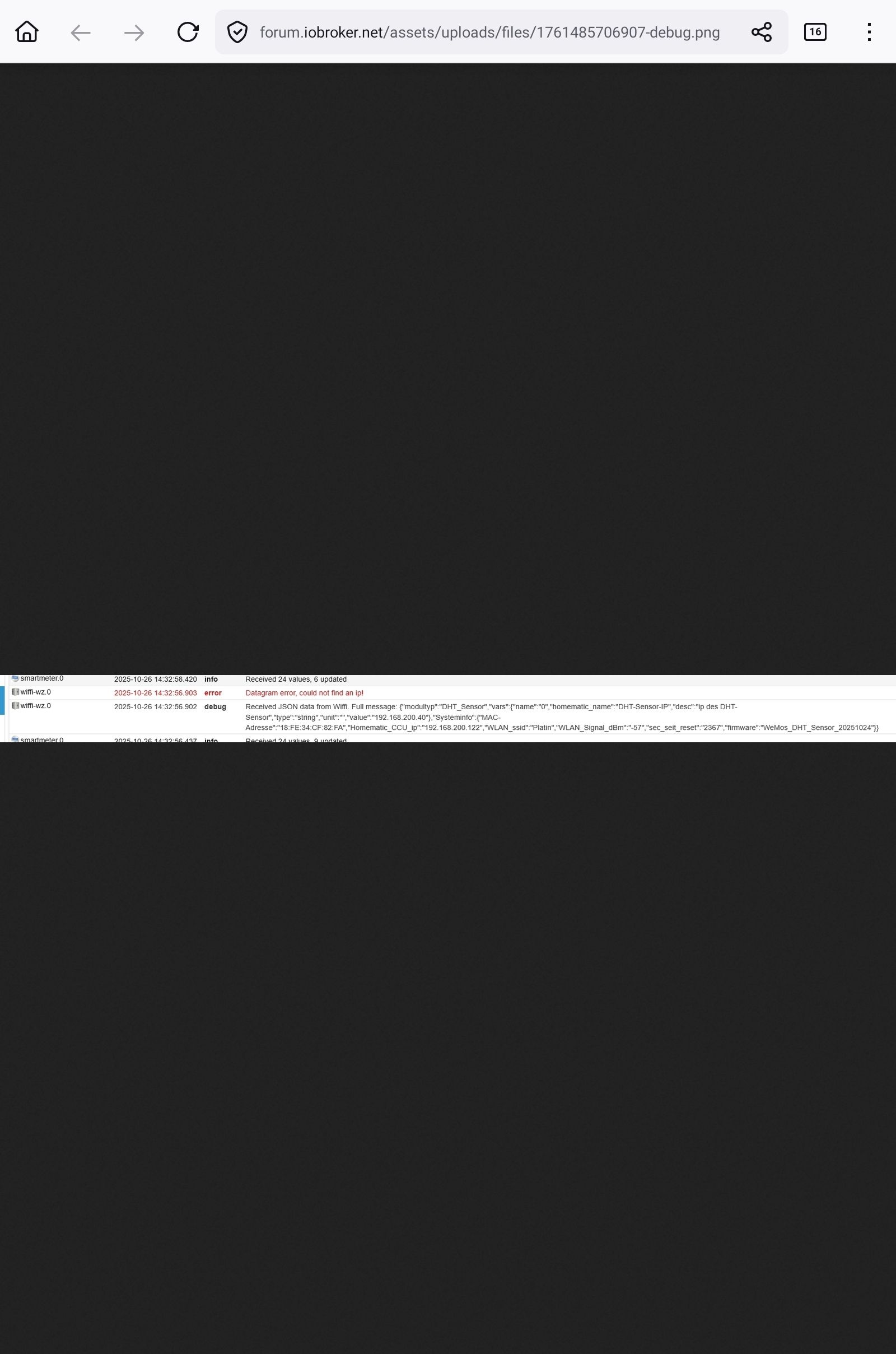

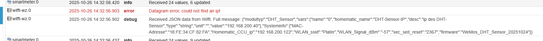

          >wiffi-wz.0
          >	2025-10-26 15:24:27.035	error	Datagram error, could not find an ip!
          >wiffi-wz.0
          >	2025-10-26 15:24:27.034	debug	Received JSON data from Wiffi. Full message: {"modultyp":"DHT_Sensor","vars":{"name":"0","homematic_name":"DHT-Sensor-IP","desc":"ip des DHT-Sensor","type":"string","unit":"","value":"192.168.200.40"},"Systeminfo":{"MAC-Adresse":"18:FE:34:CF:82:FA","Homematic_CCU_ip":"192.168.200.122","WLAN_ssid":"Platin","WLAN_Signal_dBm":"-57","sec_seit_reset":"2367","firmware":"WeMos_DHT_Sensor_20251024"}}

                              wenn ich mir deine Meldung ansehe
                              @ufelet sagte in Bereitstellung der JSON-Daten für den Wiffi-WZ Adapter:
                              und die Struktur
                              {"name":"0"
                              "type":"string",
                              "unit":"","
                              passt das irgendwie nicht zu dem Format vom Wiffi
                              {"modultyp":"wiffi-wz","vars":[{"name":"0","homematic_name":"wz_ip","desc":"ip des wiffi-wz","type":"string","unit":"","value":"192.168.123.45"},{"name":"1","homematic_name":"wz_co2","desc":"Luftqualitaet","type":"number","unit":"%","value":76},{"name":"2","homematic_name":"wz_temp","desc":"Temperatur","type":"number","unit":"gradC","value":20.0},{"name":"3","homematic_name":"wz_feuchte","desc":"Luftfeuchte","type":"number","unit":"%","value":67.2},{"name":"19","homematic_name":"wz_taupunkt","desc":"Taupunkt","type":"number","unit":"gradC","value":13.7},{"name":"18","homematic_name":"wz_feuchte_abs","desc":"Absolutfeuchte","type":"number","unit":"g/m3","value":11.6},{"name":"9","homematic_name":"wz_baro","desc":"Luftdruck","type":"number","unit":"mB","value":1002.23},{"name":"5","homematic_name":"wz_luftdrucktrend","desc":"Luftdrucktrend","type":"string","unit":"","value":"fallend"},{"name":"8","homematic_name":"wz_lux","desc":"Helligkeit","type":"number","unit":"lux","value":0.00},{"name":"6","homematic_name":"wz_motion_left","desc":"Bewegung links","type":"boolean","unit":"","value":true},{"name":"7","homematic_name":"wz_motion_right","desc":"Bewegung rechts","type":"boolean","unit":"","value":false},{"name":"20","homematic_name":"","desc":"Bewegung","type":"boolean","unit":"","value":false},{"name":"4","homematic_name":"wz_noise","desc":"Geraeusch","type":"boolean","unit":"","value":true},{"name":"10","homematic_name":"wz_elevation","desc":"Sonne-Elevation","type":"number","unit":"grad","value":-20.5},{"name":"11","homematic_name":"wz_azimut","desc":"Sonne-Azimut","type":"number","unit":"grad","value":273.9},{"name":"12","homematic_name":"wz_buzzer","desc":"Buzzer","type":"boolean","unit":"","value":false},{"name":"21","homematic_name":"","desc":"Relais","type":"boolean","unit":"","value":false}],"Systeminfo":{"MAC-Adresse":"aa.bb.cc.dd.ee.ff","ip_Homematic_CCU":"192.168.123.56","WLAN_ssid":"WLAN","WLAN_Signal_dBm":-57,"millis_seit_reset":46252671,"wiffizeit":" 1 19:21","firmware":"wiffi_wz_106"}}
                              Da fehlen bei dir die Eckigen Klammern
                              Möglich, dass deine Struktur dem Adapter nicht die IP des Sensors mitteilt, damit der Adapter die Konfiguration des Sensirs übernehmen kann
                              https://github.com/t4qjXH8N/ioBroker.wiffi-wz?tab=readme-ov-file#setup

                              • U
                                ufelet @Homoran last edited by
                                Vielen Dank.
                                Diese Möglichkeit hatte ich noch gar nicht auf dem Schirm. Das werde ich erst mal verfolgen, genauso wie die fehlenden eckigen Klammern.
                                Viele Grüße Bernd
