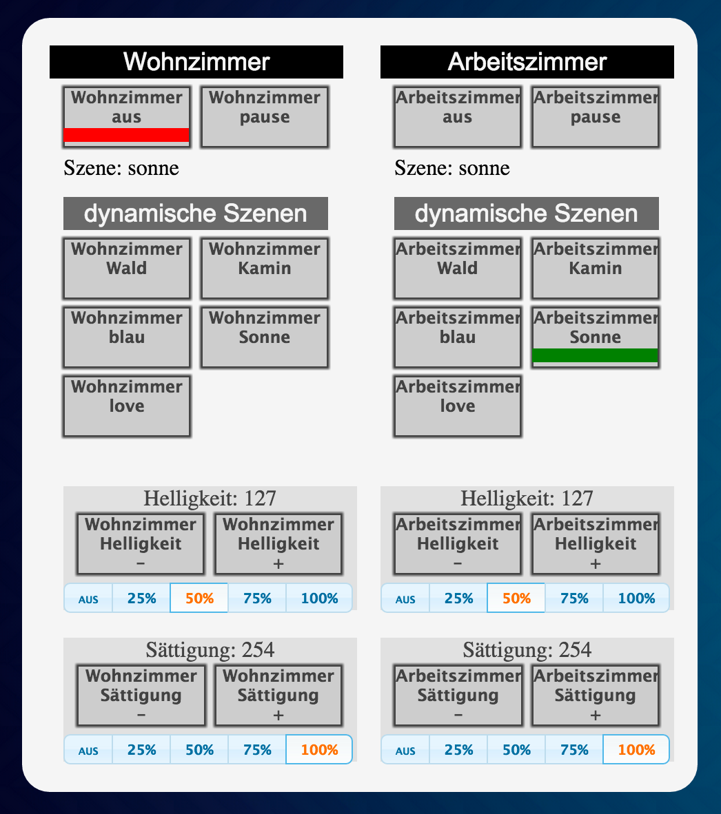

                Wenn man im Script die eigenen hue IDs eingetragen hat, kann das Script auch über VIS gesteuert werden, ohne dass man in Javascript was programmieren muss.
                Ein Beispiel für VIS:
                 ![327_iobroker_dynamische_hue_szenen_widget.png](/assets/uploads/files/327_iobroker_dynamische_hue_szenen_widget.png) [/i][/i][/i][/i][/i][/i][/i][/i]

                  Nur die linke Seite des Widgets:
                  [{"tpl":"tplBasicState","data":{"oid":"javascript.1.hue.szene.wohnzimmer.szene","visibility-cond":"==","visibility-val":"","value":"aus","html":"Wohnzimmer
                  aus","visibility-oid":"","name":"","comment":""},"style":{"left":"60px","top":"70px","background":"rgb(204, 204, 204) none repeat scroll 0% 0% / auto padding-box border-box","width":"90px","height":"42px","z-index":"10","color":"rgb(68, 68, 68)","text-align":"center","text-shadow":"none","font-family":"'Lucida Grande', 'Lucida Sans', Arial, sans-serif","font-style":"normal","font-variant":"normal","font-weight":"bold","font-size":"12px","line-height":"14px","letter-spacing":"0","word-spacing":"0px","background-position":"0% 0%","background-size":"auto","background-clip":"","background-origin":"","padding":"","box-shadow":"0px 0px 1px 1px","border-style":"solid","border-radius":"","border-width":"1px"},"widgetSet":"basic"},{"tpl":"tplHtml","data":{"visibility-cond":"==","visibility-val":1,"refreshInterval":"0","html":"dynamische Szenen","comment":""},"style":{"left":"60px","top":"150px","width":"192px","height":"24px","color":"rgb(245, 245, 245)","text-align":"center","font-family":"Arial, sans-serif","font-style":"normal","font-variant":"normal","font-weight":"400","font-size":"18px","background":"rgb(105, 105, 105) none repeat scroll 0% 0% / auto padding-box border-box","padding":"","z-index":"auto","padding-top":"","line-height":"24px"},"widgetSet":"basic"},{"tpl":"tplBasicState","data":{"oid":"javascript.1.hue.szene.wohnzimmer.szene","visibility-cond":"==","visibility-val":"","value":"kamin","html":"Wohnzimmer
                  Kamin","visibility-oid":"","name":"","comment":""},"style":{"left":"160px","top":"180px","background":"rgb(204, 204, 204) none repeat scroll 0% 0% / auto padding-box border-box","width":"90px","height":"42px","z-index":"10","color":"rgb(68, 68, 68)","text-align":"center","text-shadow":"none","font-family":"'Lucida Grande', 'Lucida Sans', Arial, sans-serif","font-style":"normal","font-variant":"normal","font-weight":"bold","font-size":"12px","line-height":"14px","letter-spacing":"0","word-spacing":"0px","background-position":"0% 0%","background-size":"auto","background-clip":"","background-origin":"","padding":"","box-shadow":"0px 0px 1px 1px","border-style":"solid","border-radius":"","border-width":"1px"},"widgetSet":"basic"},{"tpl":"tplBasicState","data":{"oid":"javascript.1.hue.szene.wohnzimmer.szene","visibility-cond":"==","visibility-val":"","value":"blau","html":"Wohnzimmer
                  blau","visibility-oid":"","name":"","comment":""},"style":{"left":"60px","top":"230px","background":"rgb(204, 204, 204) none repeat scroll 0% 0% / auto padding-box border-box","width":"90px","height":"42px","z-index":"10","color":"rgb(68, 68, 68)","text-align":"center","text-shadow":"none","font-family":"'Lucida Grande', 'Lucida Sans', Arial, sans-serif","font-style":"normal","font-variant":"normal","font-weight":"bold","font-size":"12px","line-height":"14px","letter-spacing":"0","word-spacing":"0px","background-position":"0% 0%","background-size":"auto","background-clip":"","background-origin":"","padding":"","box-shadow":"0px 0px 1px 1px","border-style":"solid","border-radius":"","border-width":"1px"},"widgetSet":"basic"},{"tpl":"tplBasicState","data":{"oid":"javascript.1.hue.szene.wohnzimmer.szene","visibility-cond":"==","visibility-val":"","value":"sonne","html":"Wohnzimmer
                  Sonne","visibility-oid":"","name":"","comment":""},"style":{"left":"160px","top":"230px","background":"rgb(204, 204, 204) none repeat scroll 0% 0% / auto padding-box border-box","width":"90px","height":"42px","z-index":"10","color":"rgb(68, 68, 68)","text-align":"center","text-shadow":"none","font-family":"'Lucida Grande', 'Lucida Sans', Arial, sans-serif","font-style":"normal","font-variant":"normal","font-weight":"bold","font-size":"12px","line-height":"14px","letter-spacing":"0","word-spacing":"0px","background-position":"0% 0%","background-size":"auto","background-clip":"","background-origin":"","padding":"","box-shadow":"0px 0px 1px 1px","border-style":"solid","border-radius":"","border-width":"1px"},"widgetSet":"basic"},{"tpl":"tplHtml","data":{"visibility-cond":"==","visibility-val":"aus","refreshInterval":"0","html":"","comment":"","visibility-oid":"javascript.1.hue.szene.wohnzimmer.szene"},"style":{"left":"60px","top":"100px","width":"91px","height":"10px","color":"rgb(245, 245, 245)","text-align":"center","font-family":"Arial, sans-serif","font-style":"normal","font-variant":"normal","font-weight":"400","font-size":"18px","background":"red","padding":"","z-index":"30","padding-top":"","line-height":"24px"},"widgetSet":"basic"},{"tpl":"tplHtml","data":{"visibility-cond":"==","visibility-val":"kamin","refreshInterval":"0","html":"","comment":"","visibility-oid":"javascript.1.hue.szene.wohnzimmer.szene"},"style":{"left":"160px","top":"210px","width":"91px","height":"10px","color":"rgb(245, 245, 245)","text-align":"center","font-family":"Arial, sans-serif","font-style":"normal","font-variant":"normal","font-weight":"400","font-size":"18px","background":"green","padding":"","z-index":"30","padding-top":"","line-height":"24px"},"widgetSet":"basic"},{"tpl":"tplHtml","data":{"visibility-cond":"==","visibility-val":"blau","refreshInterval":"0","html":"","comment":"","visibility-oid":"javascript.1.hue.szene.wohnzimmer.szene"},"style":{"left":"60px","top":"260px","width":"91px","height":"10px","color":"rgb(245, 245, 245)","text-align":"center","font-family":"Arial, sans-serif","font-style":"normal","font-variant":"normal","font-weight":"400","font-size":"18px","background":"green","padding":"","z-index":"30","padding-top":"","line-height":"24px"},"widgetSet":"basic"},{"tpl":"tplHtml","data":{"visibility-cond":"==","visibility-val":"sonne","refreshInterval":"0","html":"","comment":"","visibility-oid":"javascript.1.hue.szene.wohnzimmer.szene"},"style":{"left":"160px","top":"260px","width":"91px","height":"10px","color":"rgb(245, 245, 245)","text-align":"center","font-family":"Arial, sans-serif","font-style":"normal","font-variant":"normal","font-weight":"400","font-size":"18px","background":"green","padding":"","z-index":"30","padding-top":"","line-height":"24px"},"widgetSet":"basic"},{"tpl":"tplBasicState","data":{"oid":"javascript.1.hue.szene.wohnzimmer.szene","visibility-cond":"==","visibility-val":"","value":"wald","html":"Wohnzimmer
                  Wald","visibility-oid":"","name":"","comment":""},"style":{"left":"60px","top":"180px","background":"rgb(204, 204, 204) none repeat scroll 0% 0% / auto padding-box border-box","width":"90px","height":"42px","z-index":"10","color":"rgb(68, 68, 68)","text-align":"center","text-shadow":"none","font-family":"'Lucida Grande', 'Lucida Sans', Arial, sans-serif","font-style":"normal","font-variant":"normal","font-weight":"bold","font-size":"12px","line-height":"14px","letter-spacing":"0","word-spacing":"0px","background-position":"0% 0%","background-size":"auto","background-clip":"","background-origin":"","padding":"","box-shadow":"0px 0px 1px 1px","border-style":"solid","border-radius":"","border-width":"1px"},"widgetSet":"basic"},{"tpl":"tplHtml","data":{"visibility-cond":"==","visibility-val":"wald","refreshInterval":"0","html":"","comment":"","visibility-oid":"javascript.1.hue.szene.wohnzimmer.szene"},"style":{"left":"60px","top":"210px","width":"91px","height":"10px","color":"rgb(245, 245, 245)","text-align":"center","font-family":"Arial, sans-serif","font-style":"normal","font-variant":"normal","font-weight":"400","font-size":"18px","background":"green","padding":"","z-index":"30","padding-top":"","line-height":"24px"},"widgetSet":"basic"},{"tpl":"tplHtml","data":{"visibility-cond":"==","visibility-val":1,"refreshInterval":"0","html":"Wohnzimmer","comment":""},"style":{"left":"50px","top":"40px","width":"213px","height":"24px","color":"rgb(245, 245, 245)","text-align":"center","font-family":"Arial, sans-serif","font-style":"normal","font-variant":"normal","font-weight":"400","font-size":"18px","background":"black","padding":"","z-index":"auto","padding-top":"","line-height":"24px"},"widgetSet":"basic"},{"tpl":"tplBasicState","data":{"oid":"javascript.1.hue.szene.wohnzimmer.szene","visibility-cond":"==","visibility-val":"","value":"love","html":"Wohnzimmer
                  love","visibility-oid":"","name":"","comment":""},"style":{"left":"60px","top":"280px","background":"rgb(204, 204, 204) none repeat scroll 0% 0% / auto padding-box border-box","width":"90px","height":"42px","z-index":"10","color":"rgb(68, 68, 68)","text-align":"center","text-shadow":"none","font-family":"'Lucida Grande', 'Lucida Sans', Arial, sans-serif","font-style":"normal","font-variant":"normal","font-weight":"bold","font-size":"12px","line-height":"14px","letter-spacing":"0","word-spacing":"0px","background-position":"0% 0%","background-size":"auto","background-clip":"","background-origin":"","padding":"","box-shadow":"0px 0px 1px 1px","border-style":"solid","border-radius":"","border-width":"1px"},"widgetSet":"basic"},{"tpl":"tplHtml","data":{"visibility-cond":"==","visibility-val":"love","refreshInterval":"0","html":"","comment":"","visibility-oid":"javascript.1.hue.szene.wohnzimmer.szene"},"style":{"left":"60px","top":"310px","width":"91px","height":"10px","color":"rgb(245, 245, 245)","text-align":"center","font-family":"Arial, sans-serif","font-style":"normal","font-variant":"normal","font-weight":"400","font-size":"18px","background":"green","padding":"","z-index":"30","padding-top":"","line-height":"24px"},"widgetSet":"basic"},{"tpl":"tplBasicState","data":{"oid":"javascript.1.hue.szene.wohnzimmer.szene","visibility-cond":"==","visibility-val":"","value":"stop","html":"Wohnzimmer
                  pause","visibility-oid":"","name":"","comment":""},"style":{"left":"160px","top":"70px","background":"rgb(204, 204, 204) none repeat scroll 0% 0% / auto padding-box border-box","width":"90px","height":"42px","z-index":"10","color":"rgb(68, 68, 68)","text-align":"center","text-shadow":"none","font-family":"'Lucida Grande', 'Lucida Sans', Arial, sans-serif","font-style":"normal","font-variant":"normal","font-weight":"bold","font-size":"12px","line-height":"14px","letter-spacing":"0","word-spacing":"0px","background-position":"0% 0%","background-size":"auto","background-clip":"","background-origin":"","padding":"","box-shadow":"0px 0px 1px 1px","border-style":"solid","border-radius":"","border-width":"1px"},"widgetSet":"basic"},{"tpl":"tplHtml","data":{"visibility-cond":"==","visibility-val":"stop","refreshInterval":"0","html":"","comment":"","visibility-oid":"javascript.1.hue.szene.wohnzimmer.szene"},"style":{"left":"160px","top":"100px","width":"91px","height":"10px","color":"rgb(245, 245, 245)","text-align":"center","font-family":"Arial, sans-serif","font-style":"normal","font-variant":"normal","font-weight":"400","font-size":"18px","background":"rgb(105, 105, 105) none repeat scroll 0% 0% / auto padding-box border-box","padding":"","z-index":"30","padding-top":"","line-height":"24px"},"widgetSet":"basic"},{"tpl":"tplBasicState","data":{"oid":"javascript.1.hue.szene.wohnzimmer.bri_inc","visibility-cond":"==","visibility-val":"","value":"-16","html":"Wohnzimmer
                  Helligkeit
                  -","visibility-oid":"","name":"","comment":""},"style":{"left":"70px","top":"380px","background":"rgb(204, 204, 204) none repeat scroll 0% 0% / auto padding-box border-box","width":"90px","height":"42px","z-index":"10","color":"rgb(68, 68, 68)","text-align":"center","text-shadow":"none","font-family":"'Lucida Grande', 'Lucida Sans', Arial, sans-serif","font-style":"normal","font-variant":"normal","font-weight":"bold","font-size":"12px","line-height":"14px","letter-spacing":"0","word-spacing":"0px","background-position":"0% 0%","background-size":"auto","background-clip":"","background-origin":"","padding":"","box-shadow":"0px 0px 1px 1px","border-style":"solid","border-radius":"","border-width":"1px"},"widgetSet":"basic"},{"tpl":"tplJquiRadioSteps","data":{"oid":"javascript.1.hue.szene.wohnzimmer.bri","visibility-cond":"==","visibility-val":1,"min":"0","max":"254"},"style":{"left":"60px","top":"430px","width":"","height":"24px","font-size":"xx-small","font-variant":"small-caps","background":"","z-index":"10"},"widgetSet":"jqui"},{"tpl":"tplValueFloat","data":{"oid":"javascript.1.hue.szene.wohnzimmer.bri","visibility-cond":"==","visibility-val":1,"is_comma":"true","factor":"1","html_prepend":"Helligkeit: "},"style":{"left":"60px","top":"360px","z-index":"5","text-align":"center","width":"213px","height":"90px","color":"rgb(68, 68, 68)","background":"rgb(224, 224, 224) none repeat scroll 0% 0% / auto padding-box border-box"},"widgetSet":"basic"},{"tpl":"tplJquiRadioSteps","data":{"oid":"javascript.1.hue.szene.wohnzimmer.sat","visibility-cond":"==","visibility-val":1,"min":"0","max":"254"},"style":{"left":"60px","top":"540px","width":"","height":"24px","font-size":"xx-small","font-variant":"small-caps","background":"","z-index":"10"},"widgetSet":"jqui"},{"tpl":"tplValueFloat","data":{"oid":"javascript.1.hue.szene.wohnzimmer.sat","visibility-cond":"==","visibility-val":1,"is_comma":"true","factor":"1","html_prepend":"Sättigung: "},"style":{"left":"60px","top":"470px","z-index":"5","text-align":"center","width":"213px","height":"90px","color":"rgb(68, 68, 68)","background":"rgb(224, 224, 224) none repeat scroll 0% 0% / auto padding-box border-box"},"widgetSet":"basic"},{"tpl":"tplBasicState","data":{"oid":"javascript.1.hue.szene.wohnzimmer.sat_inc","visibility-cond":"==","visibility-val":"","value":"-16","html":"Wohnzimmer
                  Sättigung
                  -","visibility-oid":"","name":"","comment":""},"style":{"left":"70px","top":"490px","background":"rgb(204, 204, 204) none repeat scroll 0% 0% / auto padding-box border-box","width":91,"height":"42px","z-index":"10","color":"rgb(68, 68, 68)","text-align":"center","text-shadow":"none","font-family":"'Lucida Grande', 'Lucida Sans', Arial, sans-serif","font-style":"normal","font-variant":"normal","font-weight":"bold","font-size":"12px","line-height":"14px","letter-spacing":"0","word-spacing":"0px","background-position":"0% 0%","background-size":"auto","background-clip":"","background-origin":"","padding":"","box-shadow":"0px 0px 1px 1px","border-style":"solid","border-radius":"","border-width":"1px"},"widgetSet":"basic"},{"tpl":"tplBasicState","data":{"oid":"javascript.1.hue.szene.wohnzimmer.sat_inc","visibility-cond":"==","visibility-val":"","value":"16","html":"Wohnzimmer
                  Sättigung
                  +","visibility-oid":"","name":"","comment":""},"style":{"left":"170px","top":"490px","background":"rgb(204, 204, 204) none repeat scroll 0% 0% / auto padding-box border-box","width":"90px","height":"42px","z-index":"10","color":"rgb(68, 68, 68)","text-align":"center","text-shadow":"none","font-family":"'Lucida Grande', 'Lucida Sans', Arial, sans-serif","font-style":"normal","font-variant":"normal","font-weight":"bold","font-size":"12px","line-height":"14px","letter-spacing":"0","word-spacing":"0px","background-position":"0% 0%","background-size":"auto","background-clip":"","background-origin":"","padding":"","box-shadow":"0px 0px 1px 1px","border-style":"solid","border-radius":"","border-width":"1px"},"widgetSet":"basic"},{"tpl":"tplBasicState","data":{"oid":"javascript.1.hue.szene.wohnzimmer.bri_inc","visibility-cond":"==","visibility-val":"","value":"16","html":"Wohnzimmer
                  Helligkeit
                  +","visibility-oid":"","name":"","comment":""},"style":{"left":"170px","top":"380px","background":"rgb(204, 204, 204) none repeat scroll 0% 0% / auto padding-box border-box","width":"90px","height":"42px","z-index":"10","color":"rgb(68, 68, 68)","text-align":"center","text-shadow":"none","font-family":"'Lucida Grande', 'Lucida Sans', Arial, sans-serif","font-style":"normal","font-variant":"normal","font-weight":"bold","font-size":"12px","line-height":"14px","letter-spacing":"0","word-spacing":"0px","background-position":"0% 0%","background-size":"auto","background-clip":"","background-origin":"","padding":"","box-shadow":"0px 0px 1px 1px","border-style":"solid","border-radius":"","border-width":"1px"},"widgetSet":"basic"},{"tpl":"tplValueString","data":{"oid":"javascript.1.hue.szene.wohnzimmer.infoAktiveSzene","visibility-cond":"==","visibility-val":1,"html_prepend":"Szene: "},"style":{"left":"60px","top":"120px","z-index":"5","width":"192px","height":"19px"},"widgetSet":"basic"}]
                    Arminhh last edited by
                    Hallo Ruhr70,
                    danke für das neue Script! 😉 Durch das Importieren der Widgets habe ich auch verstanden wie das Skript in Vis mit Parameter aufgerufen wird. Wenn ich heute Abend zu hause bin werde ich es ausprobieren! Bin schon ganz gespannt!
                    mfg
                    Arminhh

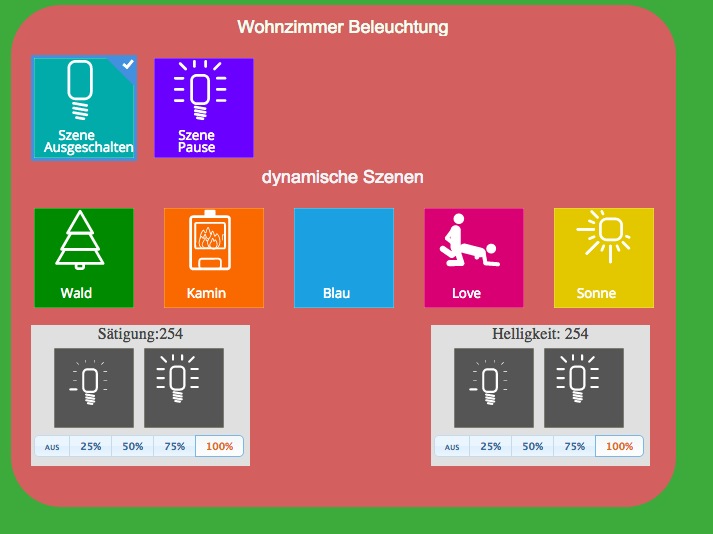

                                    Hallo Michael,
                                    danke für deine ausführliche Beschreibung!
                                    Anbei die Metroversion
                                    [{"tpl":"tplHtml","data":{"visibility-cond":"==","visibility-val":1,"refreshInterval":"0"},"style":{"left":"650px","top":"160px","width":"665px","height":"502px","z-index":"1","background-color":"#d35f5f","border-radius":"50px","border-width":"5px","border-color":"#f32020","border-style":"hidden"},"widgetSet":"basic"},{"tpl":"tplHtml","data":{"visibility-cond":"==","visibility-val":1,"refreshInterval":"0","html":"Wohnzimmer Beleuchtung","comment":""},"style":{"left":"650px","top":"170px","width":"664px","height":"21px","color":"#f1fef0","text-align":"center","font-family":"Arial, sans-serif","font-style":"normal","font-variant":"normal","font-weight":"400","font-size":"18px","background":"","padding":"","z-index":"2","padding-top":"","line-height":"24px"},"widgetSet":"basic"},{"tpl":"tplHtml","data":{"visibility-cond":"==","visibility-val":1,"refreshInterval":"0","html":"dynamische Szenen","comment":""},"style":{"left":"650px","top":"320px","width":"664px","height":"21px","color":"rgb(245, 245, 245)","text-align":"center","font-family":"Arial, sans-serif","font-style":"normal","font-variant":"normal","font-weight":"400","font-size":"18px","background":"","padding":"","z-index":"2","padding-top":"","line-height":"24px"},"widgetSet":"basic"},{"tpl":"tplMetroTileState","data":{"visibility-cond":"==","visibility-val":1,"hover":"true","transform":"true","bg_class_false":"bg-emerald","bg_class_true":"bg-red","icon_class_false":"","icon_class_true":"","icon_badge_false":"","icon_badge_true":"","badge_bg_class_false":"","badge_bg_class_true":"","brand_bg_class_false":"","brand_bg_class_true":"","state_oid":"javascript.0.hue.szene.wohnzimmer.szene","value":"wald","label_false":"Wald","icon_true":"/icons-mfd-svg/scene_x-mas.svg","icon_false":"/icons-mfd-svg/scene_x-mas.svg","icon_width":"98","icon_height":"98","icon_top":"11","icon_left":"25","label_true":"Wald","select_on_value":true},"style":{"left":"670px","top":"360px","text-align":"center","z-index":"2","width":"100","height":"100"},"widgetSet":"metro"},{"tpl":"tplMetroTileState","data":{"visibility-cond":"==","visibility-val":1,"hover":"true","transform":"true","bg_class_false":"bg-orange","bg_class_true":"bg-red","icon_class_false":"","icon_class_true":"","icon_badge_false":"","icon_badge_true":"","badge_bg_class_false":"","badge_bg_class_true":"","brand_bg_class_false":"","brand_bg_class_true":"","state_oid":"javascript.0.hue.szene.wohnzimmer.szene","value":"kamin","label_false":"Kamin","icon_true":"/icons-mfd-svg/scene_stove.svg","icon_false":"/icons-mfd-svg/scene_stove.svg","icon_width":"98","icon_height":"98","icon_top":"11","icon_left":"25","label_true":"Kamin","select_on_value":true},"style":{"left":"800px","top":"360px","text-align":"center","z-index":"2","width":"100","height":"100"},"widgetSet":"metro"},{"tpl":"tplMetroTileState","data":{"visibility-cond":"==","visibility-val":1,"hover":"true","transform":"true","bg_class_false":"bg-cyan","bg_class_true":"bg-cobalt","icon_class_false":"","icon_class_true":"","icon_badge_false":"","icon_badge_true":"","badge_bg_class_false":"","badge_bg_class_true":"","brand_bg_class_false":"","brand_bg_class_true":"","state_oid":"javascript.0.hue.szene.wohnzimmer.szene","value":"blau","label_false":"Blau","icon_true":"","icon_false":"","icon_width":"98","icon_height":"98","icon_top":"11","icon_left":"25","label_true":"Blau","select_on_value":true},"style":{"left":"930px","top":"360px","text-align":"center","z-index":"2","width":"100","height":"100"},"widgetSet":"metro"},{"tpl":"tplMetroTileState","data":{"visibility-cond":"==","visibility-val":1,"hover":"true","transform":"true","bg_class_false":"bg-magenta","bg_class_true":"bg-red","icon_class_false":"","icon_class_true":"","icon_badge_false":"","icon_badge_true":"","badge_bg_class_false":"","badge_bg_class_true":"","brand_bg_class_false":"","brand_bg_class_true":"","state_oid":"javascript.0.hue.szene.wohnzimmer.szene","value":"love","label_false":"Love","icon_true":"/icons-mfd-svg/scene_making_love.svg","icon_false":"/icons-mfd-svg/scene_making_love.svg","icon_width":"98","icon_height":"98","icon_top":"11","icon_left":"25","label_true":"Love","select_on_value":true},"style":{"left":"1060px","top":"360px","text-align":"center","z-index":"2","width":"100","height":"100"},"widgetSet":"metro"},{"tpl":"tplMetroTileState","data":{"visibility-cond":"==","visibility-val":1,"hover":"true","transform":"true","bg_class_false":"bg-yellow","bg_class_true":"bg-red","icon_class_false":"","icon_class_true":"","icon_badge_false":"","icon_badge_true":"","badge_bg_class_false":"","badge_bg_class_true":"","brand_bg_class_false":"","brand_bg_class_true":"","state_oid":"javascript.0.hue.szene.wohnzimmer.szene","value":"sonne","label_false":"Sonne","icon_true":"/icons-mfd-svg/weather_sun.svg","icon_false":"/icons-mfd-svg/weather_sun.svg","icon_width":"98","icon_height":"98","icon_top":"11","icon_left":"25","label_true":"Sonne","select_on_value":true},"style":{"left":"1190px","top":"360px","text-align":"center","z-index":"2","width":"100","height":"100"},"widgetSet":"metro"},{"tpl":"tplMetroTileState","data":{"visibility-cond":"==","visibility-val":1,"hover":"true","transform":"true","bg_class_false":"bg-indigo","bg_class_true":"bg-teal","icon_class_false":"","icon_class_true":"","icon_badge_false":"","icon_badge_true":"","badge_bg_class_false":"","badge_bg_class_true":"","brand_bg_class_false":"","brand_bg_class_true":"","state_oid":"javascript.0.hue.szene.wohnzimmer.szene","value":"aus","label_false":"Szene Ausschalten","icon_true":"/icons-mfd-svg/light_light.svg","icon_false":"/icons-mfd-svg/light_light_dim_100.svg","icon_width":"98","icon_height":"98","icon_top":"11","icon_left":"25","label_true":"Szene Ausgeschalten","select_on_value":true},"style":{"left":"670px","top":"210px","text-align":"center","z-index":"2","width":"100","height":"100"},"widgetSet":"metro"},{"tpl":"tplMetroTileState","data":{"visibility-cond":"==","visibility-val":1,"hover":"true","transform":"true","bg_class_false":"bg-indigo","bg_class_true":"bg-teal","icon_class_false":"","icon_class_true":"","icon_badge_false":"","icon_badge_true":"","badge_bg_class_false":"","badge_bg_class_true":"","brand_bg_class_false":"","brand_bg_class_true":"","state_oid":"javascript.0.hue.szene.wohnzimmer.szene","value":"stop","label_false":"Szene Pause","icon_true":"/icons-mfd-svg/light_light.svg","icon_false":"/icons-mfd-svg/light_light_dim_100.svg","icon_width":"98","icon_height":"98","icon_top":"11","icon_left":"25","label_true":"Szene Pause","select_on_value":true},"style":{"left":"790px","top":"210px","text-align":"center","z-index":"2","width":"100","height":"100"},"widgetSet":"metro"},{"tpl":"tplValueFloat","data":{"oid":"javascript.0.hue.szene.wohnzimmer.sat","visibility-cond":"==","visibility-val":1,"is_comma":"true","factor":"1","html_prepend":"Sätigung:"},"style":{"left":"670px","top":"480px","z-index":"2","text-align":"center","width":"219px","height":"141px","color":"rgb(68, 68, 68)","background":"rgb(224, 224, 224) none repeat scroll 0% 0% / auto padding-box border-box"},"widgetSet":"basic"},{"tpl":"tplValueFloat","data":{"oid":"javascript.0.hue.szene.wohnzimmer.bri","visibility-cond":"==","visibility-val":1,"is_comma":"true","factor":"1","html_prepend":"Helligkeit: "},"style":{"left":"1070px","top":"480px","z-index":"2","text-align":"center","width":"219px","height":"141px","color":"rgb(68, 68, 68)","background":"rgb(224, 224, 224) none repeat scroll 0% 0% / auto padding-box border-box"},"widgetSet":"basic"},{"tpl":"tplMetroTileState","data":{"visibility-cond":"==","visibility-val":1,"hover":"true","transform":"true","bg_class_false":"bg-gray","bg_class_true":"bg-gray","icon_class_false":"","icon_class_true":"","icon_badge_false":"","icon_badge_true":"","badge_bg_class_false":"","badge_bg_class_true":"","brand_bg_class_false":"","brand_bg_class_true":"","state_oid":"javascript.0.hue.szene.wohnzimmer.sat_inc","value":"-16","label_false":"","icon_true":"/icons-mfd-svg/light_light_dim_10.svg","icon_false":"/icons-mfd-svg/light_light_dim_10.svg","icon_width":"98","icon_height":"98","icon_top":"27","icon_left":"31","label_true":"","select_on_value":false},"style":{"left":"690px","top":"500px","text-align":"center","z-index":"3","width":"80","height":"80"},"widgetSet":"metro"},{"tpl":"tplMetroTileState","data":{"visibility-cond":"==","visibility-val":1,"hover":"true","transform":"true","bg_class_false":"bg-gray","bg_class_true":"bg-gray","icon_class_false":"","icon_class_true":"","icon_badge_false":"","icon_badge_true":"","badge_bg_class_false":"","badge_bg_class_true":"","brand_bg_class_false":"","brand_bg_class_true":"","state_oid":"javascript.0.hue.szene.wohnzimmer.sat_inc","value":"+16","label_false":"","icon_true":"/icons-mfd-svg/light_light_dim_100.svg","icon_false":"/icons-mfd-svg/light_light_dim_100.svg","icon_width":"98","icon_height":"98","icon_top":"24","icon_left":"28","label_true":"","select_on_value":false},"style":{"left":"780px","top":"500px","text-align":"center","z-index":"3","width":"80","height":"80"},"widgetSet":"metro"},{"tpl":"tplMetroTileState","data":{"visibility-cond":"==","visibility-val":1,"hover":"true","transform":"true","bg_class_false":"bg-gray","bg_class_true":"bg-gray","icon_class_false":"","icon_class_true":"","icon_badge_false":"","icon_badge_true":"","badge_bg_class_false":"","badge_bg_class_true":"","brand_bg_class_false":"","brand_bg_class_true":"","state_oid":"javascript.0.hue.szene.wohnzimmer.bri_inc","value":"-16","label_false":"","icon_true":"/icons-mfd-svg/light_light_dim_10.svg","icon_false":"/icons-mfd-svg/light_light_dim_10.svg","icon_width":"98","icon_height":"98","icon_top":"27","icon_left":"31","label_true":"","select_on_value":false},"style":{"left":"1090px","top":"500px","text-align":"center","z-index":"3","width":"80","height":"80"},"widgetSet":"metro"},{"tpl":"tplMetroTileState","data":{"visibility-cond":"==","visibility-val":1,"hover":"true","transform":"true","bg_class_false":"bg-gray","bg_class_true":"bg-gray","icon_class_false":"","icon_class_true":"","icon_badge_false":"","icon_badge_true":"","badge_bg_class_false":"","badge_bg_class_true":"","brand_bg_class_false":"","brand_bg_class_true":"","state_oid":"javascript.0.hue.szene.wohnzimmer.bri_inc","value":"+16","label_false":"","icon_true":"/icons-mfd-svg/light_light_dim_100.svg","icon_false":"/icons-mfd-svg/light_light_dim_100.svg","icon_width":"98","icon_height":"98","icon_top":"24","icon_left":"28","label_true":"","select_on_value":false},"style":{"left":"1180px","top":"500px","text-align":"center","z-index":"3","width":"80","height":"80"},"widgetSet":"metro"}]
                                      und hier ein Bild
                                      • ruhr70
                                        ruhr70 last edited by
                                        Danke!
                                        Huch, jetzt ist ioBroker erst ab 18 😉
