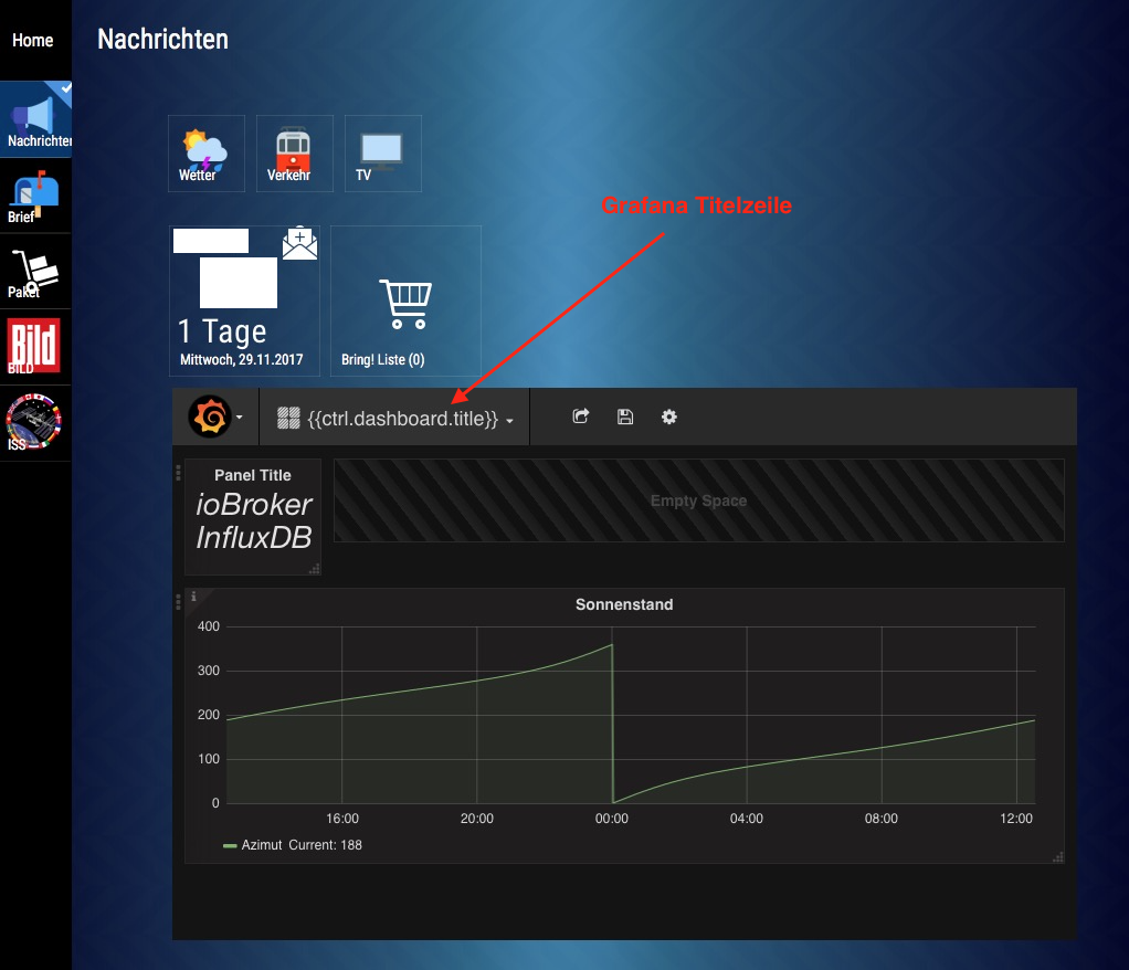

                  Frage:
                  Wie bekomme ich die Titelzeile aus dem Snapshot (siehe Screenshot).
                  Ich meine nicht den Workaround über die Änderung des Viewports, sondern eine Einstellung in Grafana.
                  Vielen Dank für die tolle Arbeit, dna909.
                  Pix

                      ` > Frage:
                      Ich meine nicht den Workaround über die Änderung des Viewports, sondern eine Einstellung in Grafana. `
                      Ist leider nicht möglich, siehe https://github.com/grafana/grafana/issues/7299
                      dna909

                        pix last edited by
                        dann muss ich es doch über diesen Weg probieren:
                        http://forum.iobroker.net/viewtopic.php … 762#p38762
                        (gezeigten iFrame Ausschnitt bestimmen)

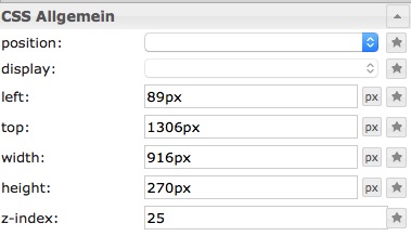

                        ! HTML-Widget: 261_bildschirmfoto_2017-11-29_um_12.11.02.jpg ````
                        ! <iframe src="{javascript.2.Grafana.DashboardURL}" id="my-iframe" scrolling="no"></iframe>
                        Dieses Widget:
                        [{"tpl":"tplHtml","data":{"g_fixed":false,"g_visibility":false,"g_css_font_text":false,"g_css_background":false,"g_css_shadow_padding":false,"g_css_border":false,"g_gestures":false,"g_signals":false,"g_last_change":false,"visibility-cond":"==","visibility-val":1,"visibility-groups-action":"hide","refreshInterval":"0","signals-cond-0":"==","signals-val-0":true,"signals-icon-0":"/vis/signals/lowbattery.png","signals-icon-size-0":0,"signals-blink-0":false,"signals-horz-0":0,"signals-vert-0":0,"signals-hide-edit-0":false,"signals-cond-1":"==","signals-val-1":true,"signals-icon-1":"/vis/signals/lowbattery.png","signals-icon-size-1":0,"signals-blink-1":false,"signals-horz-1":0,"signals-vert-1":0,"signals-hide-edit-1":false,"signals-cond-2":"==","signals-val-2":true,"signals-icon-2":"/vis/signals/lowbattery.png","signals-icon-size-2":0,"signals-blink-2":false,"signals-horz-2":0,"signals-vert-2":0,"signals-hide-edit-2":false,"lc-type":"last-change","lc-is-interval":true,"lc-is-moment":false,"lc-format":"","lc-position-vert":"top","lc-position-horz":"right","lc-offset-vert":0,"lc-offset-horz":0,"lc-font-size":"12px","lc-font-family":"","lc-font-style":"","lc-bkg-color":"","lc-color":"","lc-border-width":"0","lc-border-style":"","lc-border-color":"","lc-border-radius":10,"lc-zindex":0,"html":"\n<iframe src="&quot;{javascript.2.Grafana.DashboardURL}&quot;" id="&quot;my-iframe&quot;" scrolling="&quot;no&quot;"></iframe>\n\n\n\n"},"style":{"left":"89px","top":"1306px","z-index":"25","width":"916px","height":"270px"},"widgetSet":"basic"}]
