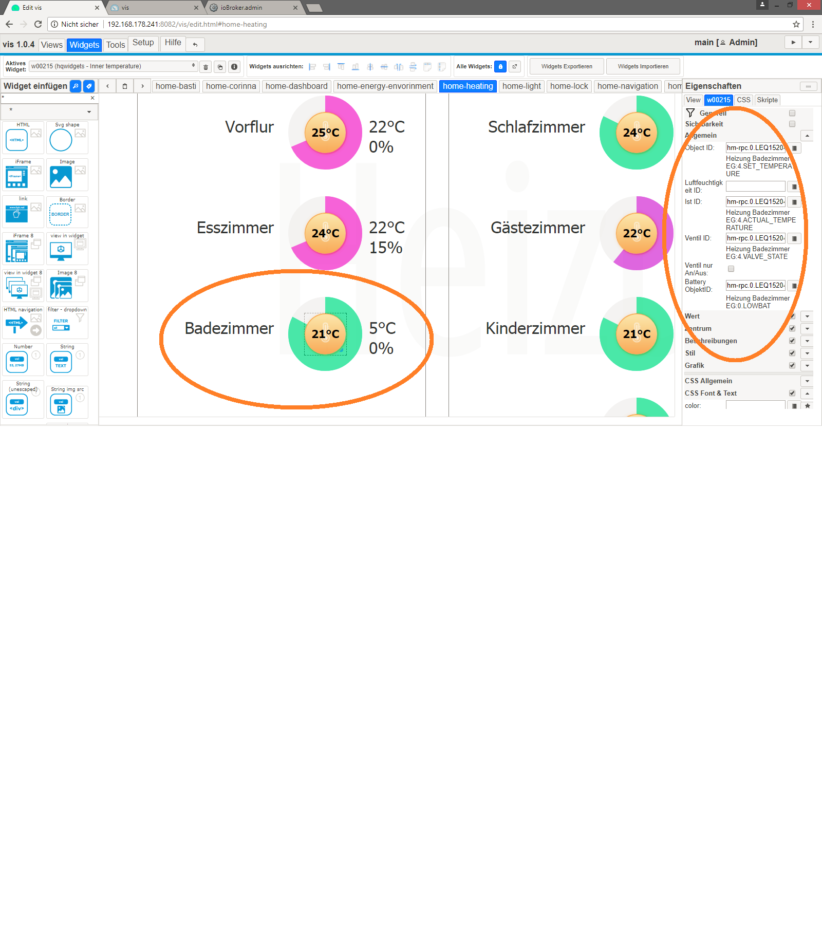

      ich würde gern das "hqWidget Inner Temperature" zur Steuerung von Homematic Heizkörper-Thermostaten nutzen.
      Folgendes habe ich eingestellt:
      Die Steuerung an sich funktioniert auch, allerdings hätte ich gern, dass der farbige Kreis den Wert der gesetzten Temperatur hat.
      Das ist bei mir irgendwie nicht der Fall 😞
      Was mache ich falsch?

        koenntest du das widget mal exportieren sieht bei mir irgendwie anders aus dan schau ich mal

          Hallo Dutchman,
          na klar. Hier der Export vom im Screenshot eingekreisten Widget:
          [{"tpl":"tplHqInTemp","data":{"g_fixed":false,"g_visibility":false,"g_css_font_text":true,"g_css_background":false,"g_css_shadow_padding":false,"g_css_border":false,"g_gestures":false,"g_signals":false,"g_last_change":false,"visibility-cond":"==","visibility-val":1,"visibility-groups-action":"hide","oid":"hm-rpc.0.LEQ1520473.4.MANU_MODE","unit":"°C","min":"4.5","max":"30.5","digits":"0","step":"1","is_comma":false,"iconName":"img/Heating.png","btIconWidth":"40","offsetAuto":true,"leftOffset":"60","topOffset":"60","circleWidth":"80","showValue":true,"timeAsInterval":false,"infoLeftFontSize":"32","infoFontRightSize":"32","infoLeftPaddingLeft":"0","infoLeftPaddingRight":"100","infoRightPaddingRight":"0","styleNormal":"hq-button-base-intemp","signals-cond-0":"==","signals-val-0":true,"signals-icon-0":"/vis/signals/lowbattery.png","signals-icon-size-0":0,"signals-blink-0":false,"signals-horz-0":0,"signals-vert-0":0,"signals-hide-edit-0":false,"signals-cond-1":"==","signals-val-1":true,"signals-icon-1":"/vis/signals/lowbattery.png","signals-icon-size-1":0,"signals-blink-1":false,"signals-horz-1":0,"signals-vert-1":0,"signals-hide-edit-1":false,"signals-cond-2":"==","signals-val-2":true,"signals-icon-2":"/vis/signals/lowbattery.png","signals-icon-size-2":0,"signals-blink-2":false,"signals-horz-2":0,"signals-vert-2":0,"signals-hide-edit-2":false,"lc-type":"last-change","lc-is-interval":true,"lc-is-moment":false,"lc-format":"","lc-position-vert":"top","lc-position-horz":"right","lc-offset-vert":0,"lc-offset-horz":0,"lc-font-size":"12px","lc-font-family":"","lc-font-style":"","lc-bkg-color":"","lc-color":"","lc-border-width":"0","lc-border-style":"","lc-border-color":"","lc-border-radius":10,"lc-zindex":0,"oid-battery":"hm-rpc.0.LEQ1520473.0.LOWBAT","descriptionLeft":"Badezimmer","alwaysShow":true,"infoColor":"","infoBackground":"transparent","infoRightPaddingLeft":"40","changeEffect":"waves","waveColor":"#00EBC1","testActive":false,"dialog_open":false,"oid-actual":"hm-rpc.0.LEQ1520473.4.ACTUAL_TEMPERATURE","oid-drive":"hm-rpc.0.LEQ1520473.4.VALVE_STATE","valveBinary":false,"caption":"","midTextColor":"#000000","dialog_timeout":"400","oid-humidity":""},"style":{"left":"400px","top":"628px","width":"80px","height":"80px","z-index":"1","font-size":"22px","text-align":""},"widgetSet":"hqwidgets"}]

            der fehler sitzt in deiner object id, da steht hm-rpc.0.LEQ1520473.4.MANU_MODE sollte aber hm-rpc.0.LEQ1520473.4.SET_TEMPERATURE sein
              SchuetzeSchulz last edited by
              Super, jetzt scheint es zu passen. Danke Dir!
