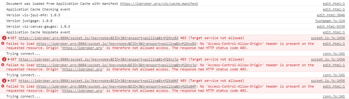

      ****Anzeige VIS:****
       ![3116_error_vis.jpg](/assets/uploads/files/3116_error_vis.jpg)
      Document was loaded from Application Cache with manifest https://iobroker.pro/vis/cache.manifest

      2socket.io.js:1456 GET https://iobroker.pro:8084/socket.io/?key=nokey&EIO=3&transport=polling&t=M2Xnx8X 403 (Target service not allowed)

      edit.html:1 Failed to load https://iobroker.pro:8084/socket.io/?key=nokey&EIO=3&transport=polling&t=M2Xnx8X: No 'Access-Control-Allow-Origin' header is present on the requested resource. Origin 'https://iobroker.pro' is therefore not allowed access. The response had HTTP status code 403.
      conn.js:141 Trying connect...

      edit.html:1 Failed to load https://iobroker.pro:8084/socket.io/?key=nokey&EIO=3&transport=polling&t=M2Xnzjp: No 'Access-Control-Allow-Origin' header is present on the requested resource. Origin 'https://iobroker.pro' is therefore not allowed access. The response had HTTP status code 403.
      Was mich stutzig macht, ist dass im Log steht das socketio auf 8082 gestartet wird aber er auf 8084 nachschaut.
      web.0 2017-12-29 10:11:31.289 info http server listening on port 8082
      web.0 2017-12-29 10:11:31.282 info socket.io server listening on port 8082
      web.0 2017-12-29 10:11:30.844 info Allow states only when user is owner: false
      web.0 2017-12-29 10:11:30.840 info simpleAPI server listening on port 8082
      web.0 2017-12-29 10:11:30.594 info starting. Version 2.1.9 in /opt/iobroker/node_modules/iobroker.web, node: v6.12.2
      Auch die Installation vom Adapter socket.io und Anpassung der Einstellungen brachte keine Verbesserung.
      Habt Ihr vielleicht eine Idee woran das liegt? Wie habt Ihr das eingestellt? Als Browser habe ich Chrome/FF/IE ausprobiert, nutze aber hauptsächlich Chrome.
                edit.html:1 Application Cache Checking event
                edit.html:3846 Version vis-jqui-mfd: 1.0.5
                justgage.js:114 Version justgage: 1.0.0
                edit.html:9339 Version vis-canvas-gauges: 1.0.5
                edit.html:1 Application Cache NoUpdate event
                Request.create @ socket.io.js:1456
                Request @ socket.io.js:1369
                XHR.request @ socket.io.js:1297
                XHR.doPoll @ socket.io.js:1327
                Polling.poll @ socket.io.js:1740
                Polling.doOpen @ socket.io.js:1684
                Transport.open @ socket.io.js:827
                Socket.open @ socket.io.js:248
                Socket @ socket.io.js:129
                Socket @ socket.io.js:55
                Manager.open.Manager.connect @ socket.io.js:4549
                Manager @ socket.io.js:4403
                Manager @ socket.io.js:4372
                lookup @ socket.io.js:4301
                init @ conn.js:234
                main @ vis.js:3556
                (anonymous) @ vis.js:3818
                j @ jquery-1.11.2.min.js:2
                fireWith @ jquery-1.11.2.min.js:2
                ready @ jquery-1.11.2.min.js:2
                J @ jquery-1.11.2.min.js:2
                vg
                Falk `
                8082 und 8084 sind falsch. So sieht es bei mir aus:
                https://iobroker.pro/socket.io/?key=nokey&EIO=3&transport=polling
                Kannst du eingebaute Socket.io Ausprobieren?

                                  Es hat zwischenzeitlich funktioniert, aber aktuell funktioniert VIS (1.0.4) über iobroker.pro nicht mehr. Veränderungen wurden nicht vorgenommen. Es wurde lediglich hqwidgets(1.1.1) installiert. Es erscheint folgender Fehler:
                                  Uncaught ReferenceError: getUsedObjectIDs is not defined
                                  at Object.getUsedObjectIDs (vis.js:316)
                                  at vis.js:1725
                                  at conn.js:521
                                  Folgendes habe ich schon ausprobiert, aber leider ohne Erfolg:
                                    • iobroker upload all bzw. iobroker upload vis
                                  - Neustart iobroker
                                  Was könnte die Ursache sein? Danke im voraus.
                                  vg
                                  Falk

                                          Wollte nun heute von extern anfangen meine VIS zu modifizieren, aber der Fehler erscheint nun wieder :oops: . Am Wochenende funktionierte es. Kann es sein, dass es am Browser/OS/NW liegt?
                                          Am WE mit Safari am IPad im Heimnetzwerk (wo ich auch direkt ohne Cloud Zugriff habe) funktionierte es und nun mit Chrome/FF in Windows ohne direkten Zugriff (Hotspot) funktioniert es nicht.
                                          Browser-Cache wurde natürlich mehrmals gelöscht…
                                          Von extern hat es aber schon mal funktioniert. Ich glaube aber da war iobroker noch auf RPi3(Stretch). Es ist nun umgezogen auf einen Rock64 mit Armbian.
                                          vg
                                          Falk
                                          • Bluefox
                                            Bluefox last edited by
                                            @schittl:
                                            vg
                                            Falk `
                                            Es liegt an dem Browsecache. Bitte löschen.
