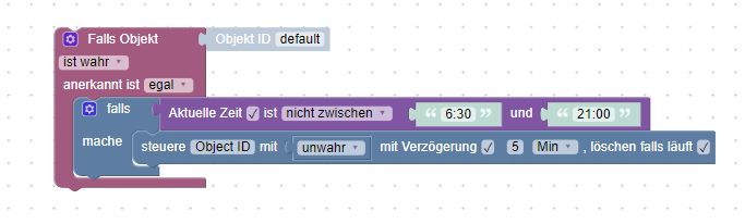

          andyb last edited by
          So zum Beispiel….
          Du musst noch in dem Trigger bei "default" und bei steuere "Object ID" deinen Treppenhaus Aktor eintragen.
          <xml xmlns="http://www.w3.org/1999/xhtml"><block type="on_ext" id="pd#X~DUqP5=FD5q7=mho" x="-587" y="288"><mutation items="1"></mutation>
          <value name="OID0"><shadow type="field_oid" id="Q*0:O*N9DTgc5edAg`Z:"><field name="oid">default</field></shadow></value>
          <statement name="STATEMENT"><block type="controls_if" id="}p_?eWzl4i-Av8aa=Rsy"><value name="IF0"><block type="time_compare_ex" id="-sNo?ZWU3,LuYof}]Hb,"><mutation end_time="true" actual_time="true"></mutation>
                  <field name="OPTION">not between</field>
                  <value name="START_TIME"><shadow type="text" id="V2f|.I]-GRH2q#N/Sjpf"><field name="TEXT">6:30</field></shadow></value>
                  <value name="END_TIME"><shadow type="text" id="k!?0J;]`^JI/zt!TQ*4R"><field name="TEXT">21:00</field></shadow></value></block></value>
              <statement name="DO0"><block type="control" id="p1*hK@,d|cBia^f;%dw2"><mutation delay_input="true"></mutation>
                  <field name="DELAY_MS">5</field>
                  <value name="VALUE"><block type="logic_boolean" id="@m:S=8azC0rI{5JtT4:3"><field name="BOOL">FALSE</field></block></value></block></statement></block></statement></block></xml>
